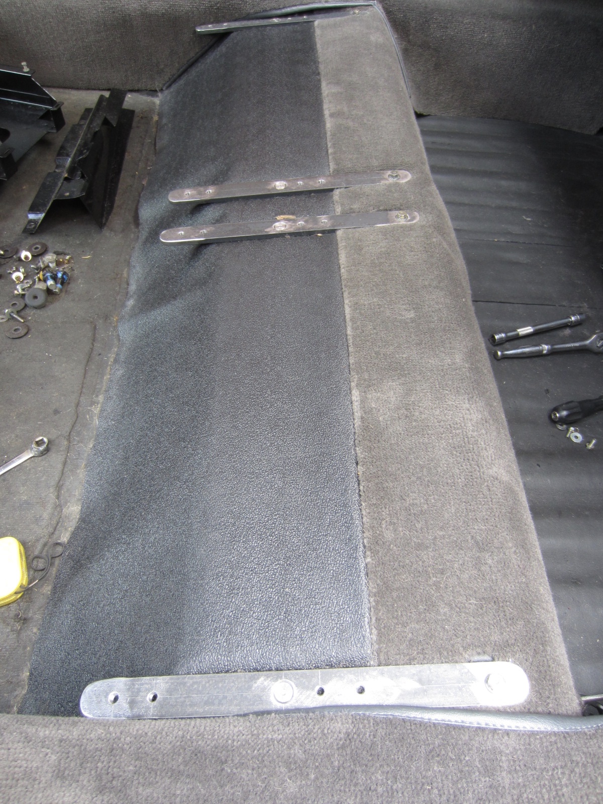

    seat runners
    above is during a trial fitting on top of the carpet. But mounted like this, the front sections are visible when seat is right back. I considered making/printing some plastic covers to hide the front sections.
    But i’m now thinking to fit them ‘under’ the carpet. Cutting out the underlayers where they sit will bring them level with underlay and provide a somewhat firmer mounting, not being bolted through layers of crushed carpet & foam etc.
    I would need to make exit holes in the hardura for the bar coming out the rear & punch new holes for the frame, but that will leave the forward original hole exposed. Hence the thoughts of making a new section. Either that or attempt to cover/fill the existing hole. Maybe a plastic disc/plug of sorts might not look so bad and even allow access to the mounting-screw without removing the carpet? The rear hole will be covered by the seat-frame. Might be onto something there?
    Possibly oem made the centre carpet glued on top because of the bulk. I think if you wanted a fairly flat seam, you’d have to stich it flat and even hammer it too flatten it more? I know you won’t really see it, but it’s there.
    Yes, the bulkhead carpet stiched inside out is proper isn’t it. Coverdal look to do it the same as oem, as with other sections too. Stiching like this also ‘bows’ out the top opening nicely. Instead of being somewhat flat like mine? I guess soemhting in there will shape it out anyway.
    I know the carpets will look great when finally fitted with a complete interior. Specific flaws detracted by the overall look of inside and mostly not even seen. You can somewhat over-focus looking specifically, in deatil at a particular point. Anyway, don’t worry Coverdale did not make the carpet. Brian Cates did ~17 years.
    A quick google now responds with good, OK & don’t use. Mostly from many years ago. No idea if he is still trading? My experience is ‘OK’. Overall is good, but finishing is poor I.M.O.
    I will play with tank-lid & the centre-carpet, my extension-runners and think about options. I’m liking my sudden idea about plug/discs to cover holes. Will simplify work alot.
