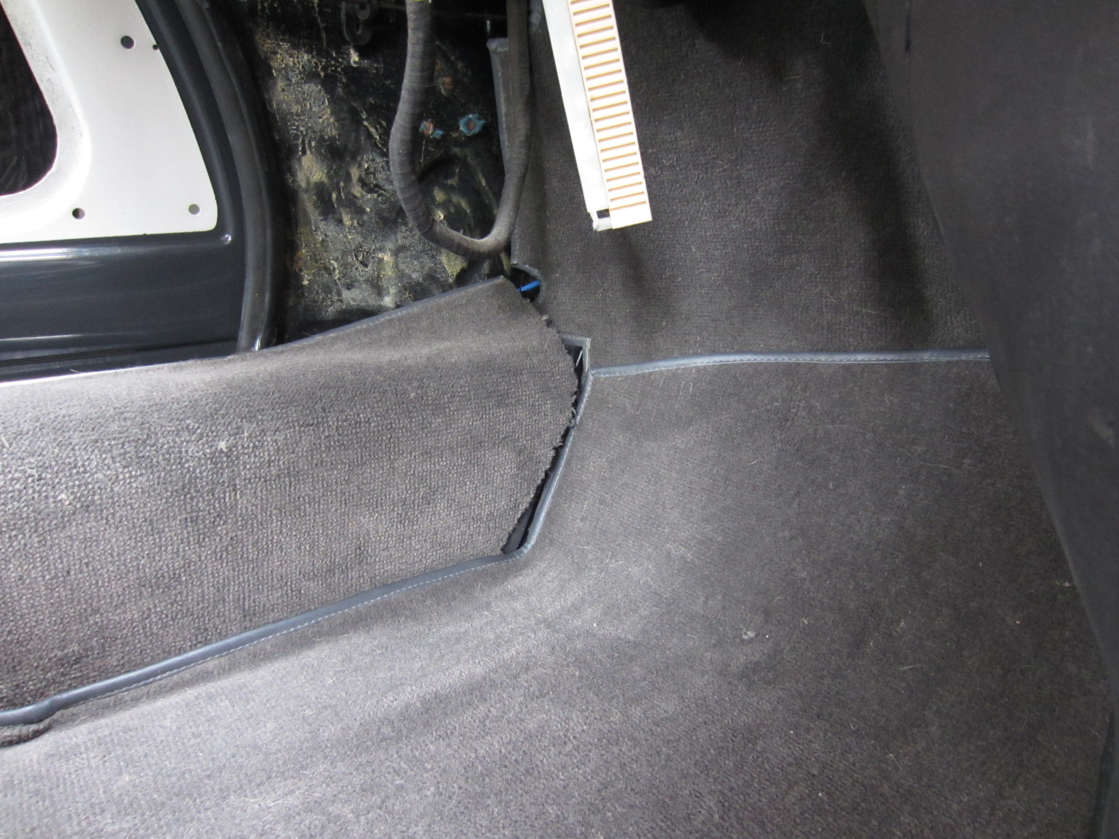

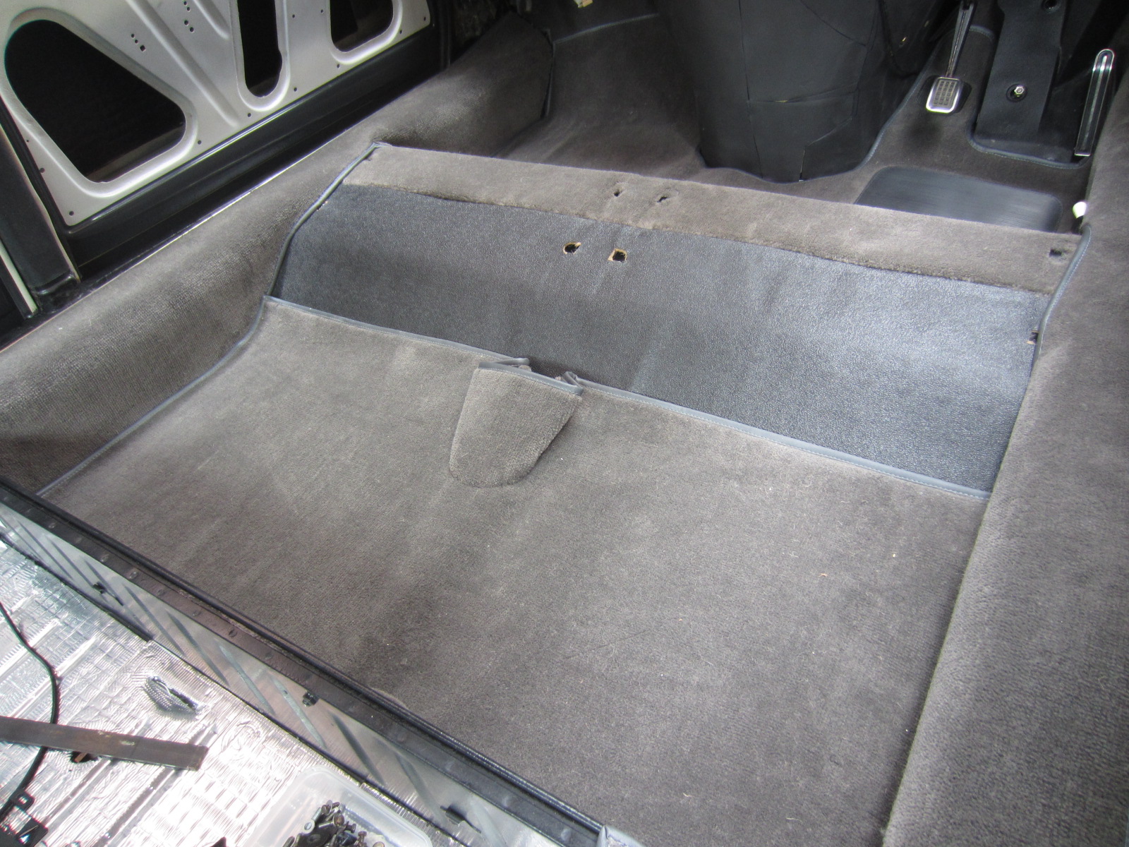

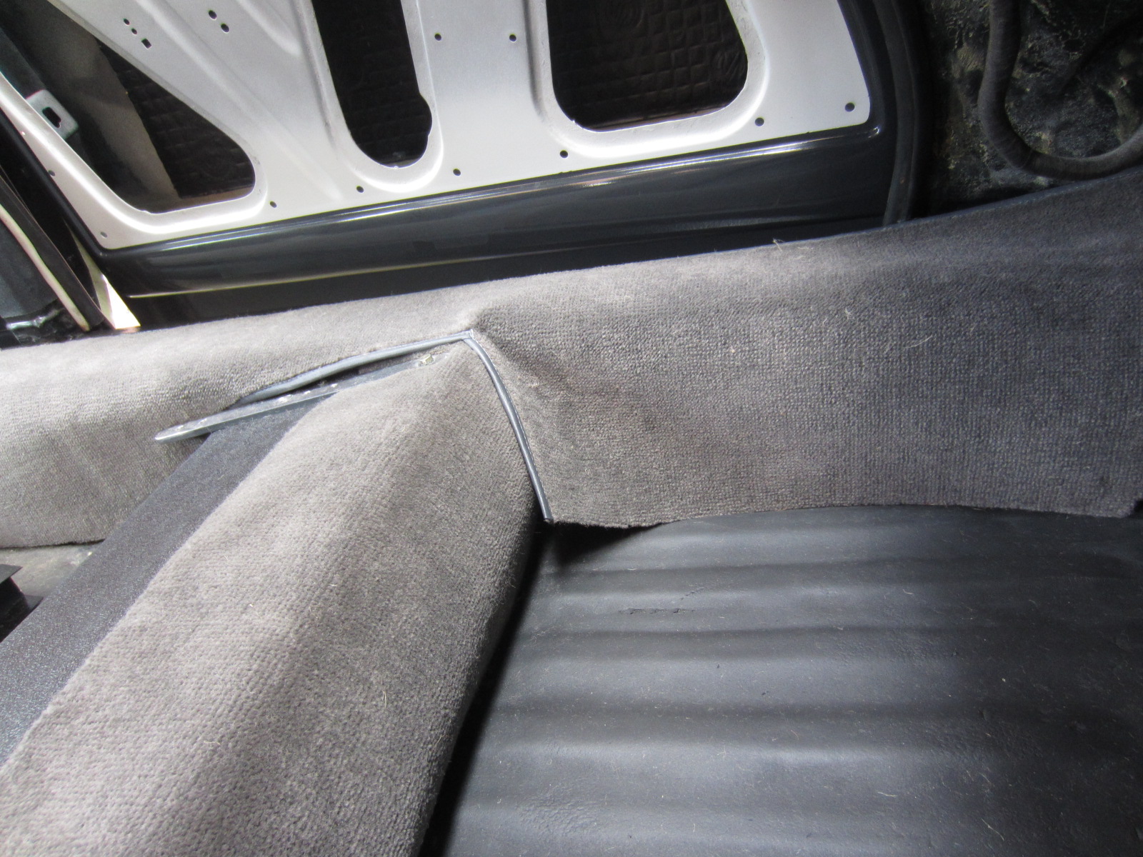

Overall the carpet fits OK. but i do have some issues that need to be addressed.
main issue is that the sill carpets, when aligned with the ‘curve’ on the sill-trim and the ‘slope’ of the centre floor section. They fall short at the fronts. NS is the worst.
but, it may be OK-ish? I think the floor carpet should sit on top of the ECU that bolts to the floor. If so, it’ll fit covering those gaps? The cage that the ECU sits in looks to have a cover or somehting, with four captive-nuts ftted on the frame that something bolted too.

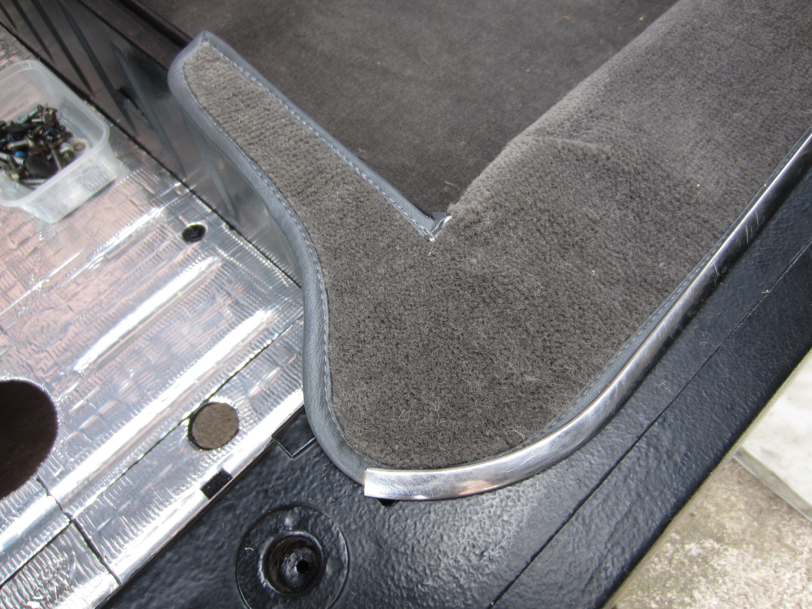

Also the bit that fits on the corner around the tank isn’t ideal.
ive opened up the trim, so the edging fits inside and then will be clamped back down/tight after final fitting. Again, if you align the curve on the carpet with the curve of the trim. it dictates where the carpet fits. align curves, carpet falls short at front of sill. move carpet forward to correct gaps at front. it looks odd with misalignment of curve on carpet & trim.
all carpet sets i’ve seen , including coverdale, simply have a slit, edged for this area. but its more complicated than that. there is a lip on that upper edge of the panels. the carpet slot idealy needs to be an upside-down ‘L’?
Anyway, i have time having to sort out the sills/bottom of C/B posts. during that i’ll consider my options. I’m leaning to get some more flint grey carpet from coverdale, enough for the boot and use offcuts to extend the sill carpets and fill tha minor gaps?

Thanks for the links. I looked at C.Classics parts shop and didn’t see it, don’t think they stock it?Carpet, yeah. I htink it’s just a balls up on the supplier/maker. It was a bloke recommended from here many years ago. I’ve been somewhat dissapointed in the whole lot to be honest. The actual finishing in a lot of areas, particular seating/door cards isn’t quite up to scrtatch for a pro in my book. It looks a little ameteur.
I could fit that NS sill carpet so it sits behind the centre section. But the centre-section has a raw edge, so that will be visible and look bad. I’d have to edge it, then its odd to the other side and it goes on.
I’m thinking of replacing it with a coverdale? They seem to have a good rep? I’ll try the other carpets and see how good/bad they fit before making a decision. If going coverdale i’ll talk to them first about their fitment. It might be the same?
I have some time. My understanding is I have sme minor works to sills before I can final-fit the sill carpets and follow on from that with the rest, due to the order of ‘over-lapping’ trim that requires fitting:

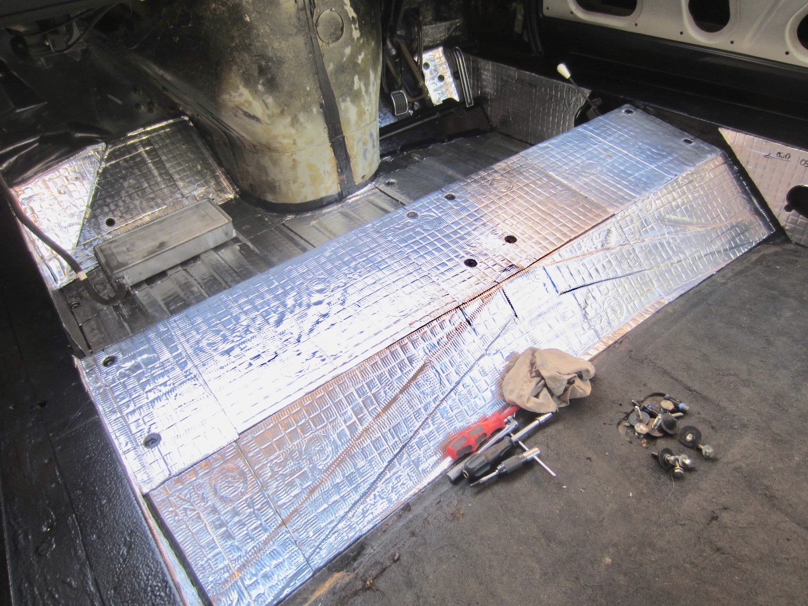

keep us posted on your endeavours.interior now covered with sound deadening bitumen or whatever it is & sound isolator closed cell foam.
i have been trial fitting the carpets which i bought some fifteen plus years ago and have been in storage until now. i’ve got an issue with the N/S sill carpet. i think it’s the wrong type for the car? it looks to be for one that doesn’t have the height-adjuster-rod-linkage running infront of the centre floor-section?
the O/S sill carpet is correct, having the shape cut for the adjusting-lever. it can be seen in the image above showing the foam sound-isolator.
Looks like I’ll have to rework it; trim it to follow the shape and re-apply binding.

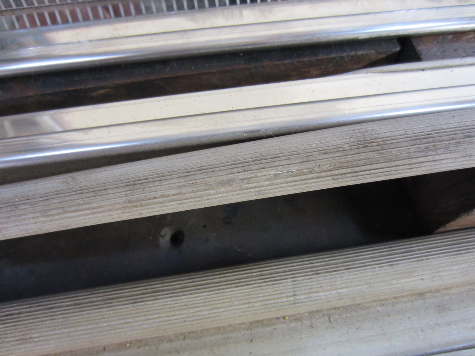

Secondly, does anyone know if the rubber trim that fits around the steel trim that secures the upper sill-covers is available anywhere? Three out the four of mine are somewhat damaged.
