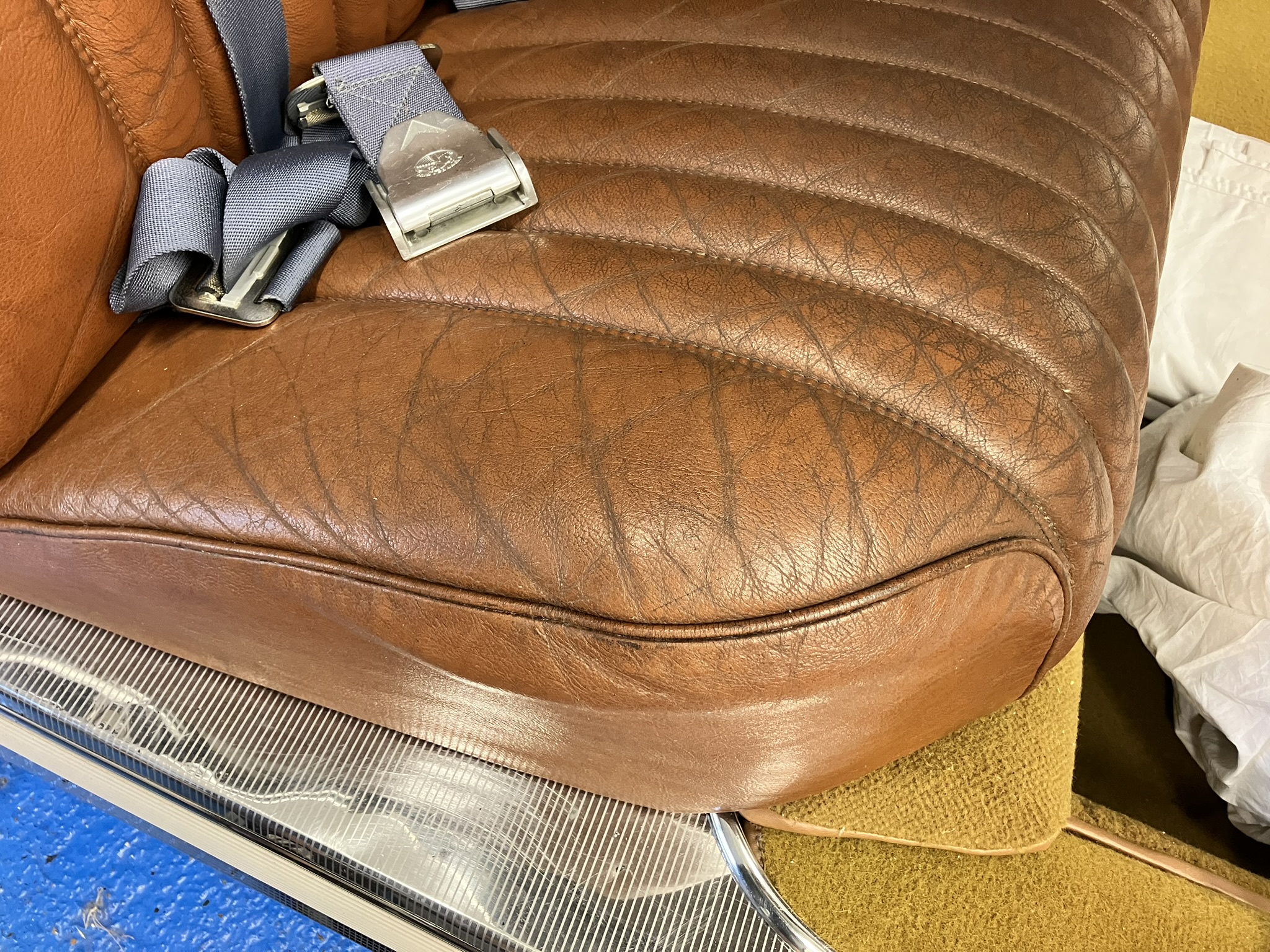

    Carpet and rear seat. Here is my fitted rear seat relative to the pallas trim. With the seat fitted, you can just about see the round hole that the seat base clips into, but you can’t see the edge of the stainless trim.
