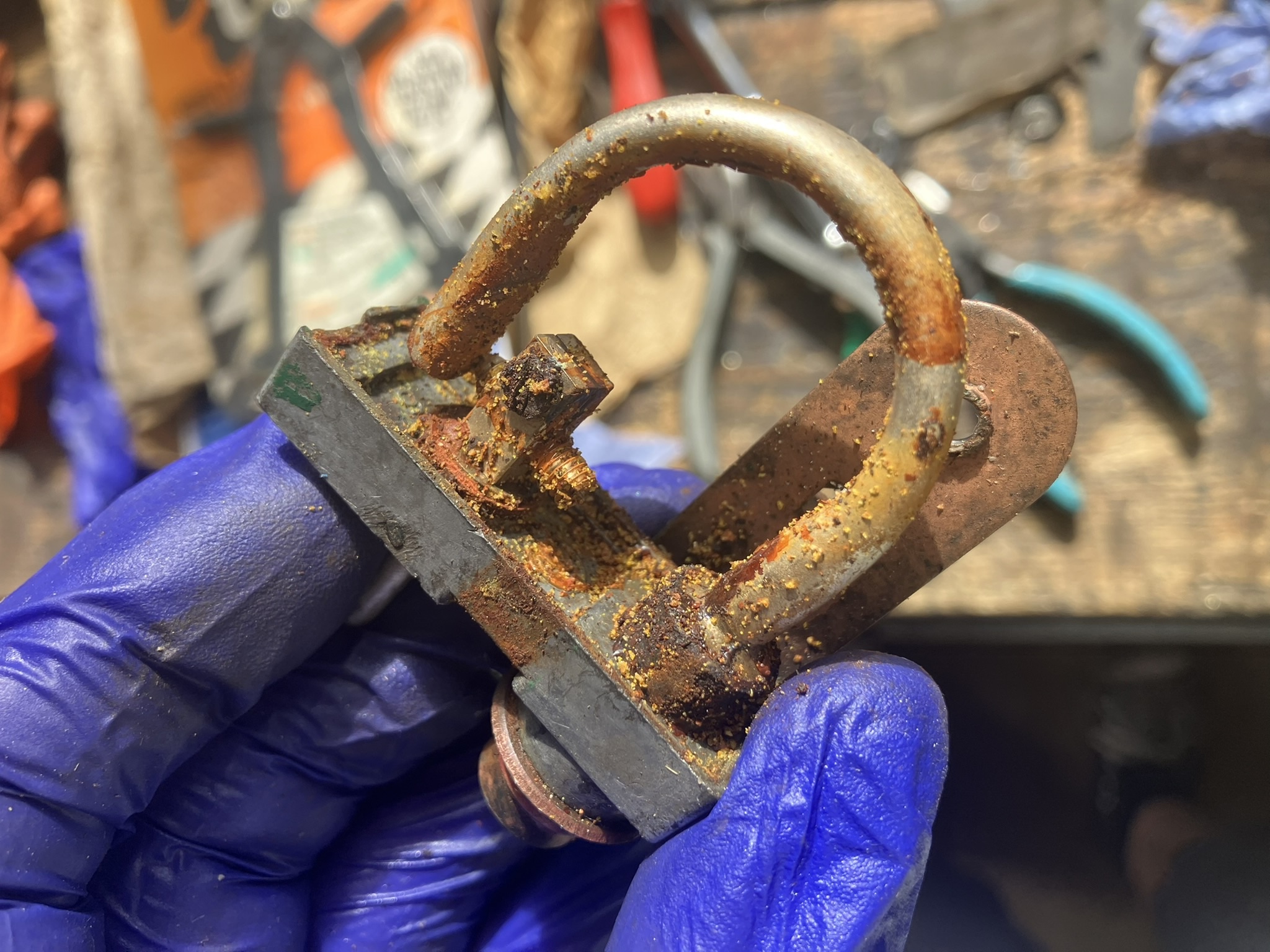

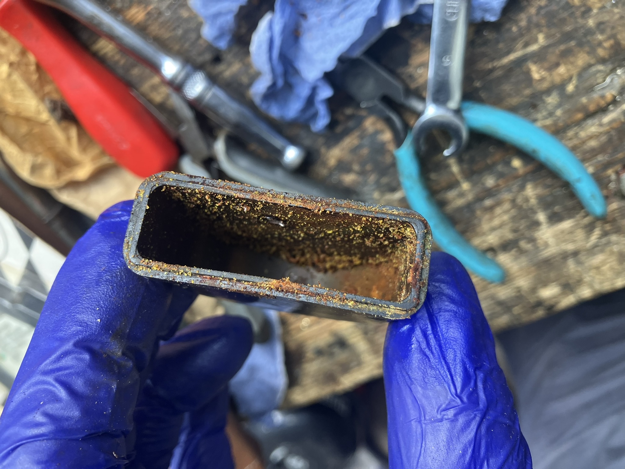

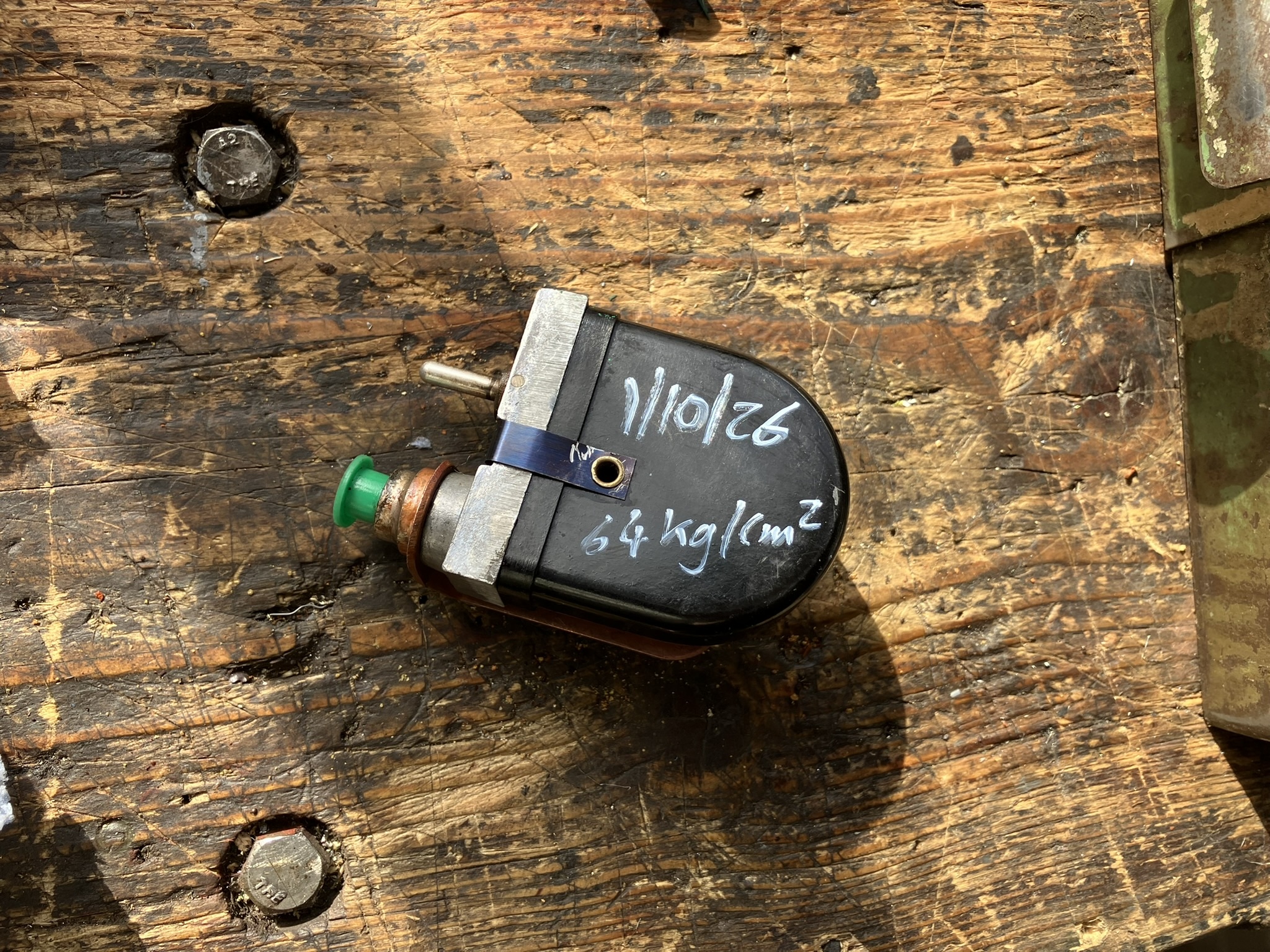

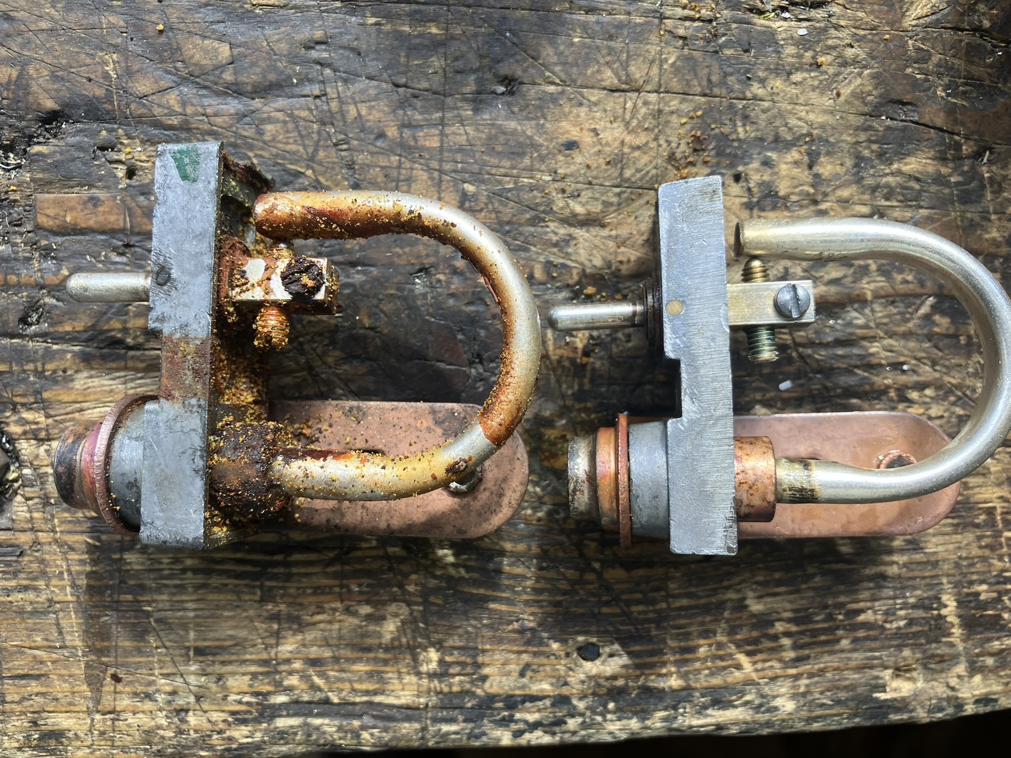

    Hydraulic pressure switch and associated warning light now working as Andre intended 🙂
    After I’d discovered that mine worked in a bench test, but operated at only 22 KG/cm2 (about 22 bar), I temporarily refitted it to the car. Frustratingly – it didn’t work on the car!
    I got another from Holland and, on testing, it worked at 60 bar – just on the margins of ‘in spec.’. I removed my old one again and decided to recalibrate it while i was at it – just for the learning. It was no good as it was. It proved easy to re-calibrate but in removing the rivet holding its case on, the drill slipped and shattered the plastic case.
    That being so, I planned to fit the other one I’d got from holland. But I decided to slightly recalibrate it so that it was in the middle of spec. About 65 bar. I could also clean the contacts. I removed the cover (carefully this time) and this is what i found. Piles of rust! It had looked fine from the outside.
    I’m so glad i didn’t just fit it in its 60 bar mode! In the end, i’ve used my original switch – recalibrated to 64 kg/ cm2 – and used only the cover from the spare i bought.
    I think I’ve worked out why – when still in its 22 bar mode – it didn’t work when refitted. I’m guessing that there is residual pressure in the switch that is not released when the engine is turned off or even when the pressure regulator bolt is loosened. After refitting and starting the engine, I think pressure in my car didn’t drop to 22 bar or below – so my light never came back on. I think that – again, when it was in its 22 bar mode – if I’d opened the brake bleed screws, pressure would have dropped to zero and my light would have come on – but it still needed fixing.
    Now that it’s correctly recalibrated, if pressure drops to anything below 64 bar the light will come back on. And, if my theory is correct, there can’t be that much residual pressure in the system.
    Next/ last job is to bleed the front brakes again. then i can investigate the suspected air ingress on my carb.

    It’s a really simple circuit.The dash warning light is simply negatively earthed by the hydraulic switch. it would be easy to put a buzzer in behind the dashboard, but you’d need to put up with it being on when you first start the car and until pressure rises. Realistically though, the red idiot light is right in front of you when you’re driving so should be hard to miss. Should be…
    in reply to: Nearly There! #13432
    I bought another pressure switch from Mark Hidding over in Holland. It’s still a sealed unit and I gave it a test this morning. I thought you might like to see a video of that test.
    At zero pressure the dashboard warning light should be illuminated. As pressure reaches between 60 and 70 bar, the warning light should extinguish – meaning it’s safe to drive the car. If pressure drops to below 60 bar, the dash warning light should illuminate again. the test shows both of these tests.
    Triggering at 60 bar, the switch is *just* within spec. I may dismantle and clean my other switch and see if that alters the trigger pressure. Ultimately I will just recalibrate it if need be.
