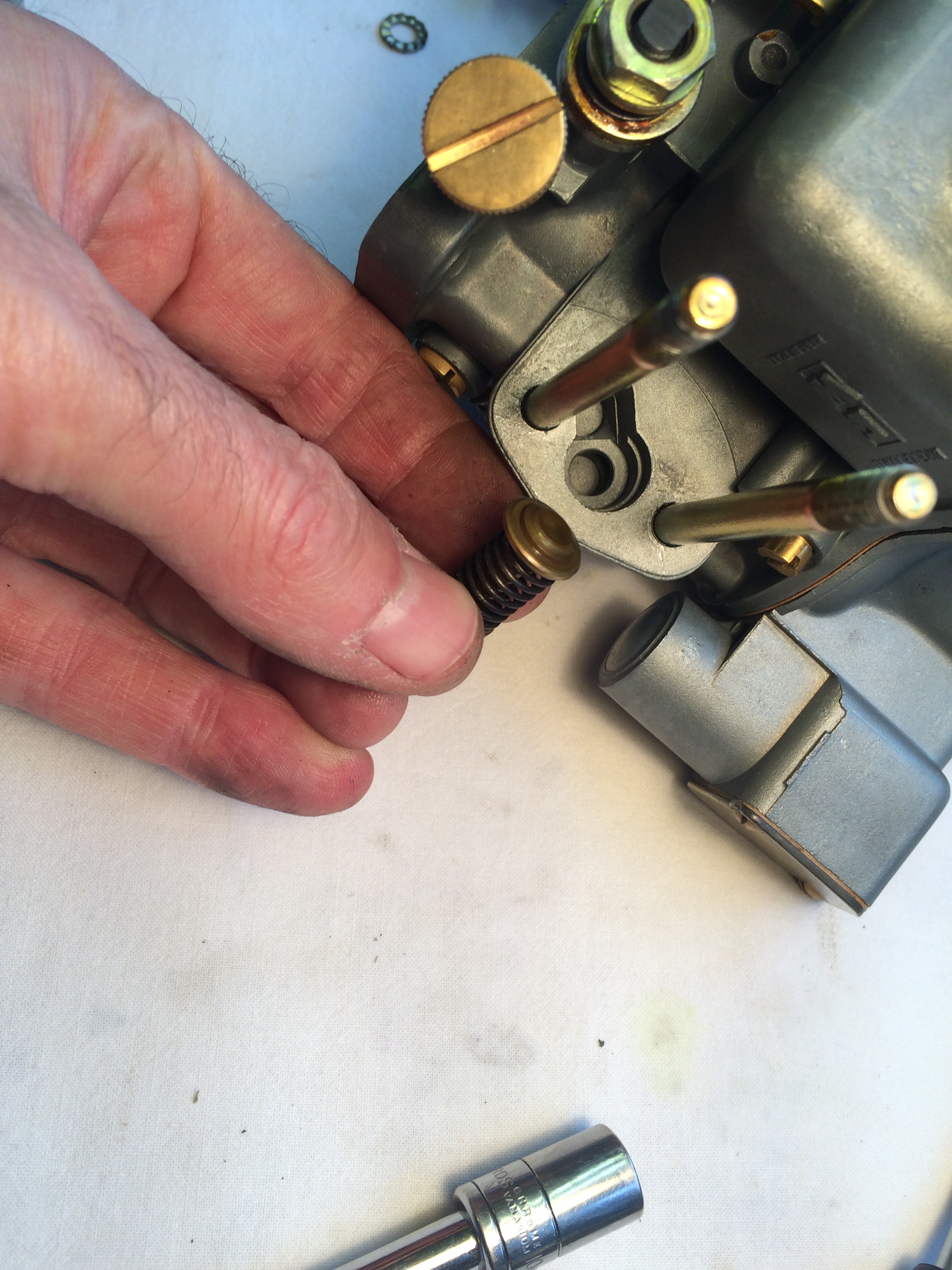

    There are a few bits in the accelerated idling device. Have you got them all? There is the slide valve:
    And then the plunger on the end that seals the hole.
    Notice also the slit brass sleeve around the plunger.
    I can’t follow your logic re: timing, but i suspect that is because there isn’t any 🙂 If you’re happy, you’re happy.
